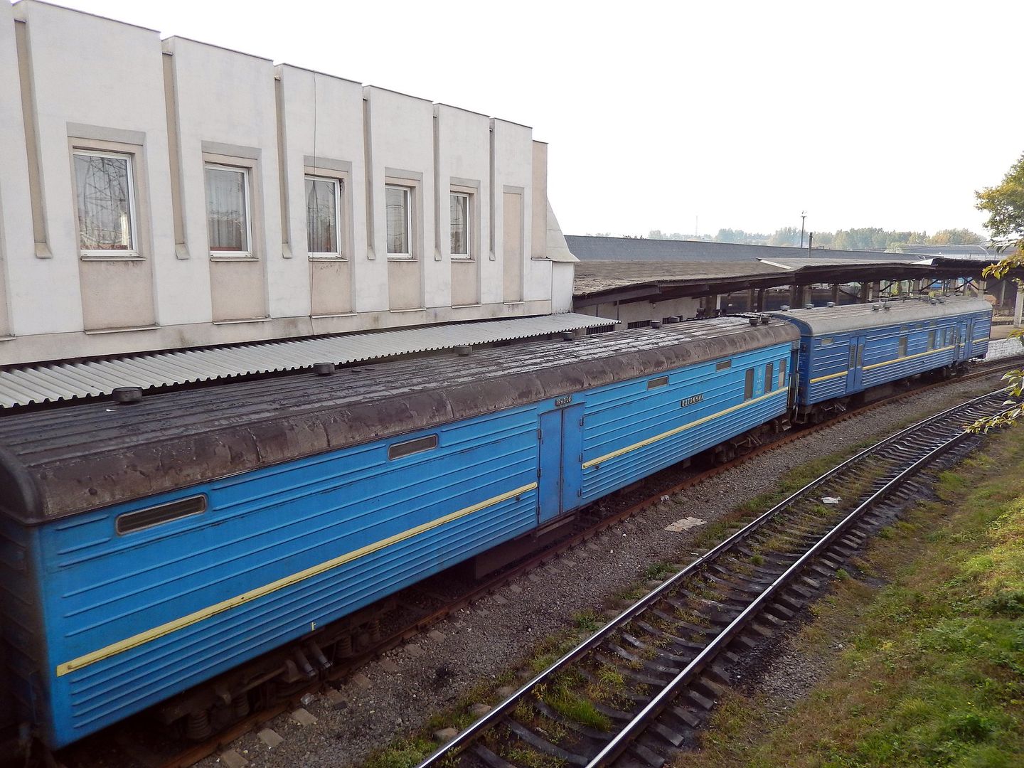

https://www.facebook.com/groups/1837984 ... 406437099/Postbahnhof Lviv, Ukraine (09.10.2013).
